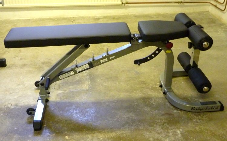

Tobbe Arnesson Posted June 22, 2011 Report Share Posted June 22, 2011 Just make sure you won't be able to step on the wheel in the up-folded position, wheels are kinda slippery. I had a close call with my weight training bench: Notice the wheels on the far left of the legs. They get engaged when lifting the other end a bit of the ground, that system might also work for some light weight tools in the shop. Quote Link to comment Share on other sites More sharing options...
