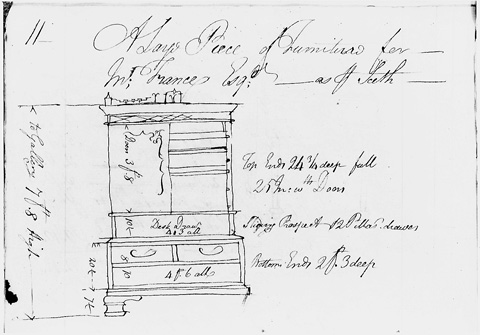

In the article, he talks about a 1766 estimate book from the Lancaster, England firm of Robert Gillow. One such entry in the estimate book describes a clothespress, which would likely take about the same amount of time as a highboy or large chest on chest. The entry contained a drawing of the item:
The entry for this clothespress "notes that five joiners completed the case with a combined labor expenditure of ten weeks and two days. The carving shown on the cornice and in the corners of the doors was not included in the total." Carving was typically a specialized task that was contracted out to a professional carver, so it makes sense that the carving was not included in the time estimate in the Gillow account book.
"According to Robert Campbell’s The London Tradesman (1747), eighteenth-century cabinetmakers worked six days a week and twelve hours a day. This observation is reinforced by several entries in the Gillow account books, which calculate the workmen’s time in days and hours. Since the highest hourly total listed was eleven, it implies that a twelve-hour day was typical in the Gillow shop as well. Using this standard, the total number of hours invested in Mr. France’s clothespress would have been 744."
So about 750 total man hours to complete something the size of a highboy or tall chest on chest, including the finishing. The Gillow shop spread that 744 hours of work out among 5 different joiners to complete the piece. So that equates to just over 2 weeks of work per person. It's not noted the actual time it took to build the piece in real time, just in labor time. I think we can safely assume it wasn't delivered in 2 weeks as the finishing process itself takes longer than that due to drying times. However, to finish a piece this complex even in ten real weeks is amazing. They likely finished it half that time with the 5 joiners working on it. Considering the amount of work that goes into these pieces, that is an extremely fast pace to work without machines. If you consider our typical 40 hour work week, that would mean it would take one person today about 18½ weeks, or a little over 4 months, to finish the piece, including the finish, working on it for 8 hours per day, 5 days per week. I don't think most of us could do that today.

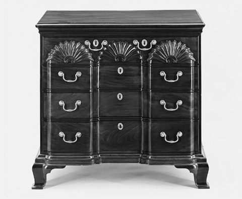

Master Headley also noted that the Hay Shop in Williamsburg would complete a small Newport style piece like the one pictured below in about 260 total man hours, including finishing. So for 1 person to work on it, it would require about 6½ weeks, working 40 hours per week.

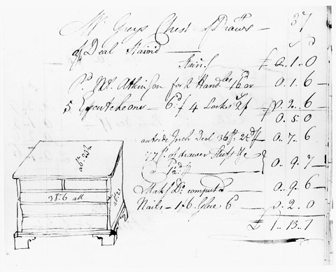

I think the 6½ weeks for one person that the Hay shop would put into the Newport piece above would be very fast, but it gets even crazier :o. Master Headley also noted in the article that it is clear from research that the Newport craftsmen were much faster than this and could make the same piece in significantly less time. As a comparison, a similar, but slightly less complex and ornate small chest like the one pictured below was noted to take about 66 man hours to complete (including the finishing) in the Gillow account. While the chest is less complex and ornate than the Newport example pictured above, that's still a huge difference in time for a similarly sized piece.
At 66 man hours, we're talking about a little over 1 week and 3 days of hands on time for one person to complete this chest working 40 hours per week. So they could basically build a simple chest like the one pictured above in 5-6 modern work days (3-4 18th century work days!), then spend the remaining time on the finishing (probably a couple hours per day spread over another week or two to total another 2-3 modern work days). I'd be lucky to have all the rough milled boards hand planed in a week. Forget about completing the build. That would take me probably 2 months, before I even thought about the finish. It's clear these guys were extremely fast. I don't think most people could build this chest with machines in a week, using solid wood and traditional joinery methods.
