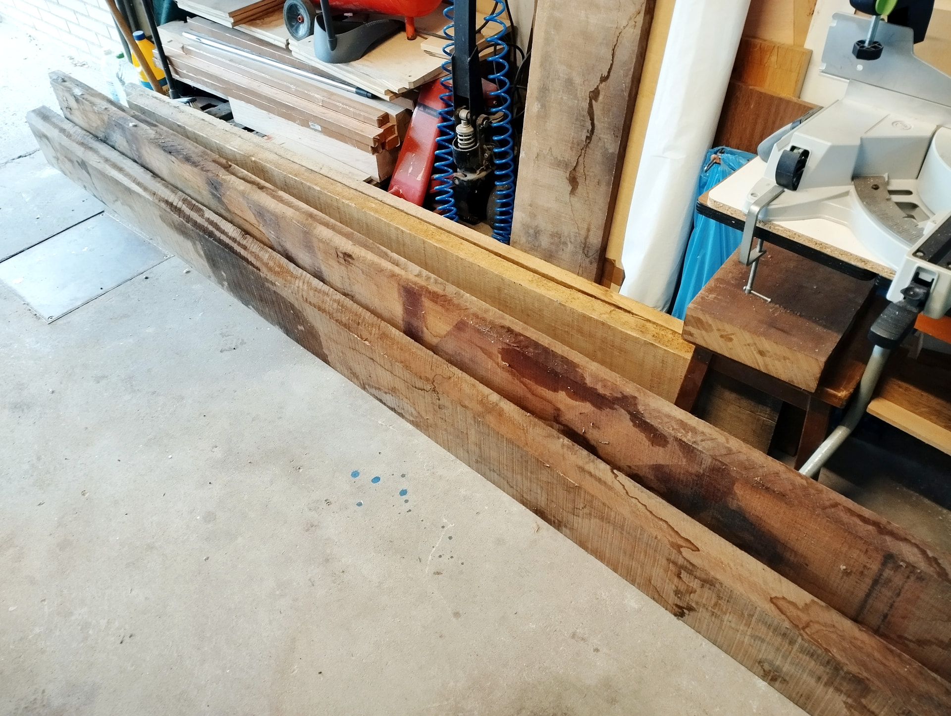

Popular Post Sergio Escudero Posted January 30 Author Popular Post Report Posted January 30 On 1/29/2026 at 11:52 PM, wtnhighlander said: I would go with the bar stool pictured last, myself. The armless design is a bit less complicated to build. The curved back piece, called a 'crest rail', can be steam bent, or a bent lamination. The butt-shaped seat is usually called 'sculpted'. I think the trickiest part of making such a chair is getting the correct 'sight lines' for drilling the spindle holes, everything lines up correctly. That involves marking lines on the seat to mark the radius of the curve, and spacing of the spindles, along with a bevel gauge to guide your drill at the desired splay angle. It is more complicated to describe than to do. Maybe find some videos similar to this one for a visual reference: Some people use modern laser levels and mirrors to aid drill alignment, but pencil lines and a bevel gauge work fine. Fantastic video, very informative, but now I'm more scared than before. Anyway, there's no turning back now. I left the wood acclimating inside the workshop; it will stay there for a couple of weeks. It also got a little wet when I removed the plastic tarp that was covering it. There was a little water in a fold and it dripped onto the wood. I have white oak and jatoba. There are some planks that cannot be seen in the photo because the wider ones (up to 30 cm) cover them, but there is a tatoba plank that is 7 cm thick and about 15 cm wide. What wood should I choose? I like the reddish brown color of jatoba, I think it's very elegant, but it's also very expensive and this is all I have. 3 Quote
Popular Post wtnhighlander Posted January 30 Popular Post Report Posted January 30 Either species should work, so long as you respect the strengths an weaknesses of each. I sm not so familiar with jatoba, but white oak is strong, heavy, and rives (splits) well along its grain. Selecting straight-grained parts for all the spindles & legs, and splitting them to rough size, will help avoid breakage. Windsor chairs are often painted, because multiple species are used to gain advantage for different parts of the chair. Oak for spindles and legs (riven, straight, and strong), soft pine for the sculpted seat (easier to carve), and maple for the crest rail (resists wear & tear) were common. Traditional methods also involve baking the spindles to shrink them before assembly, and using slightly 'green' wood for the seat and crest rail. This allows the spindle ends to swell, and the holes to shrink, resulting in a tight fit, without glue. Let me be clear, I am only passing along knowledge from observing others, I do not build chairs, myself. 4 Quote
