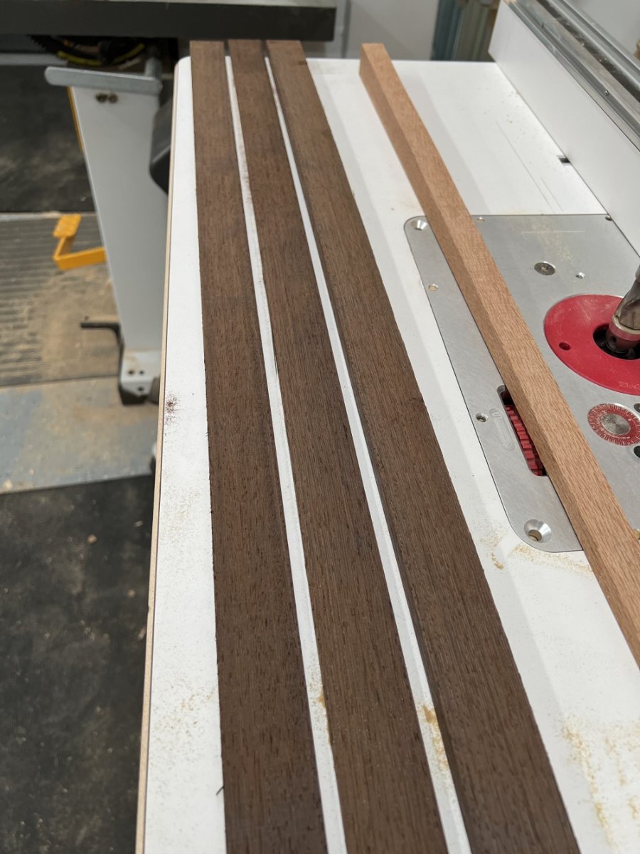

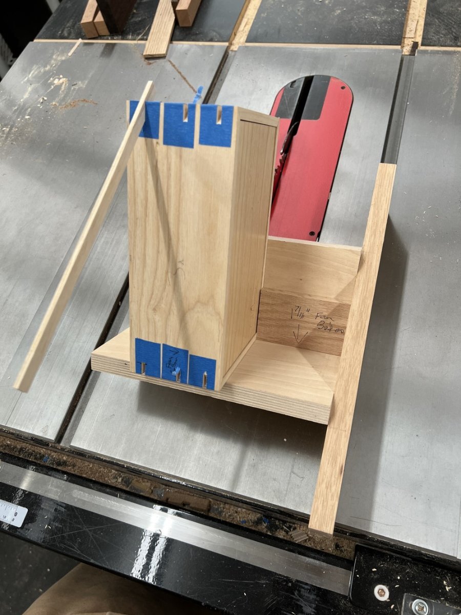

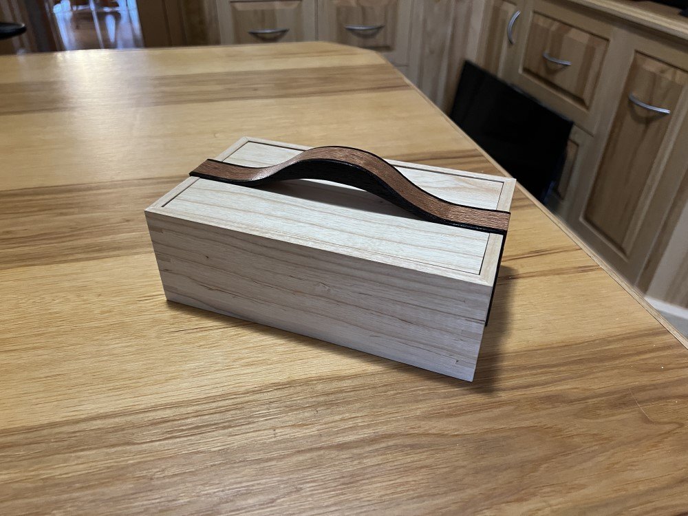

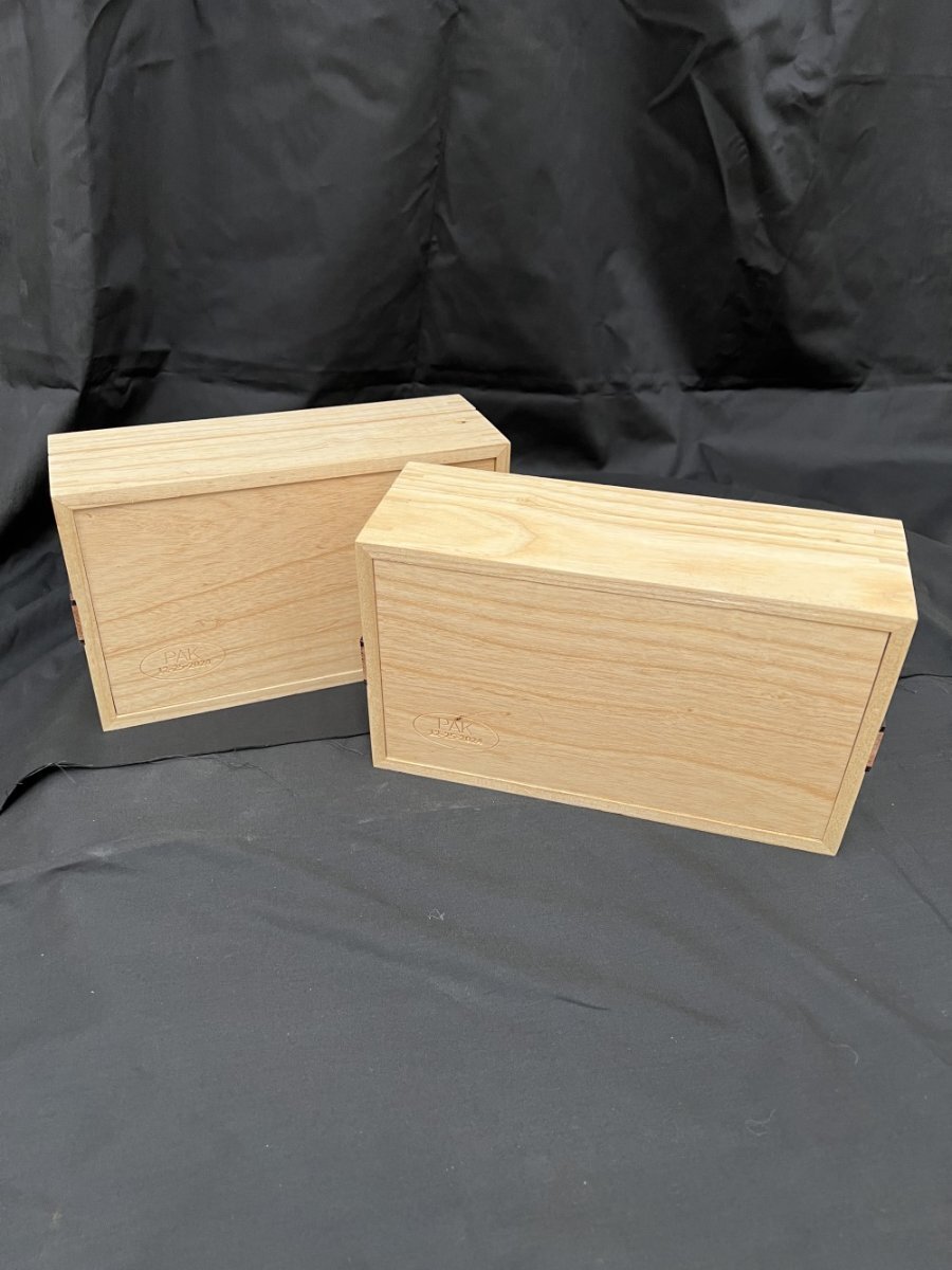

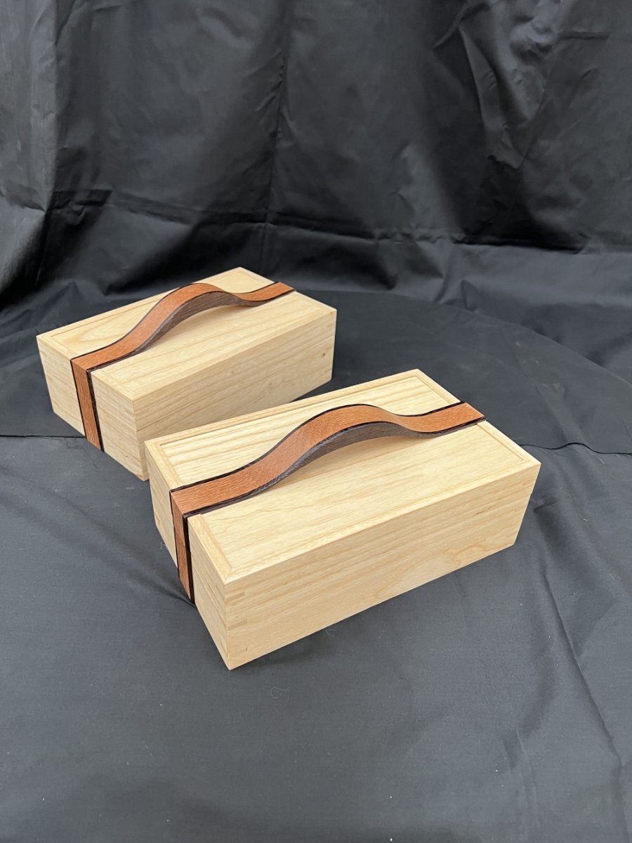

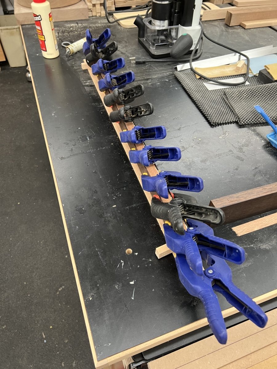

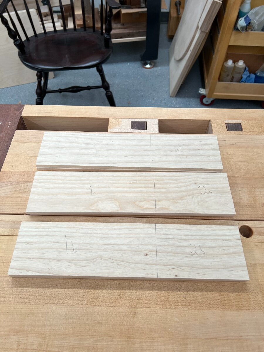

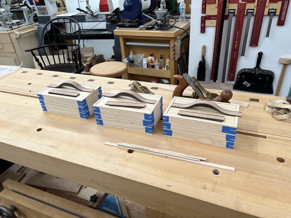

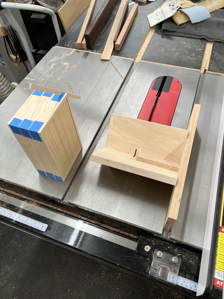

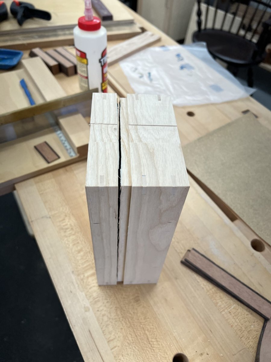

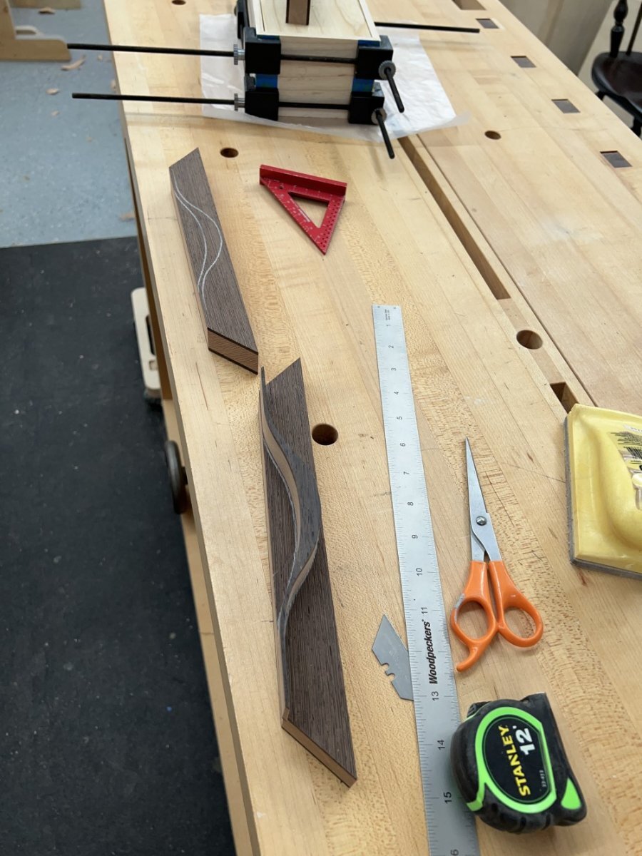

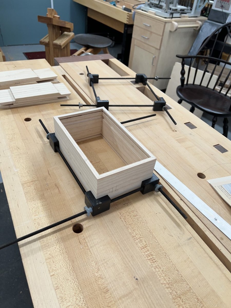

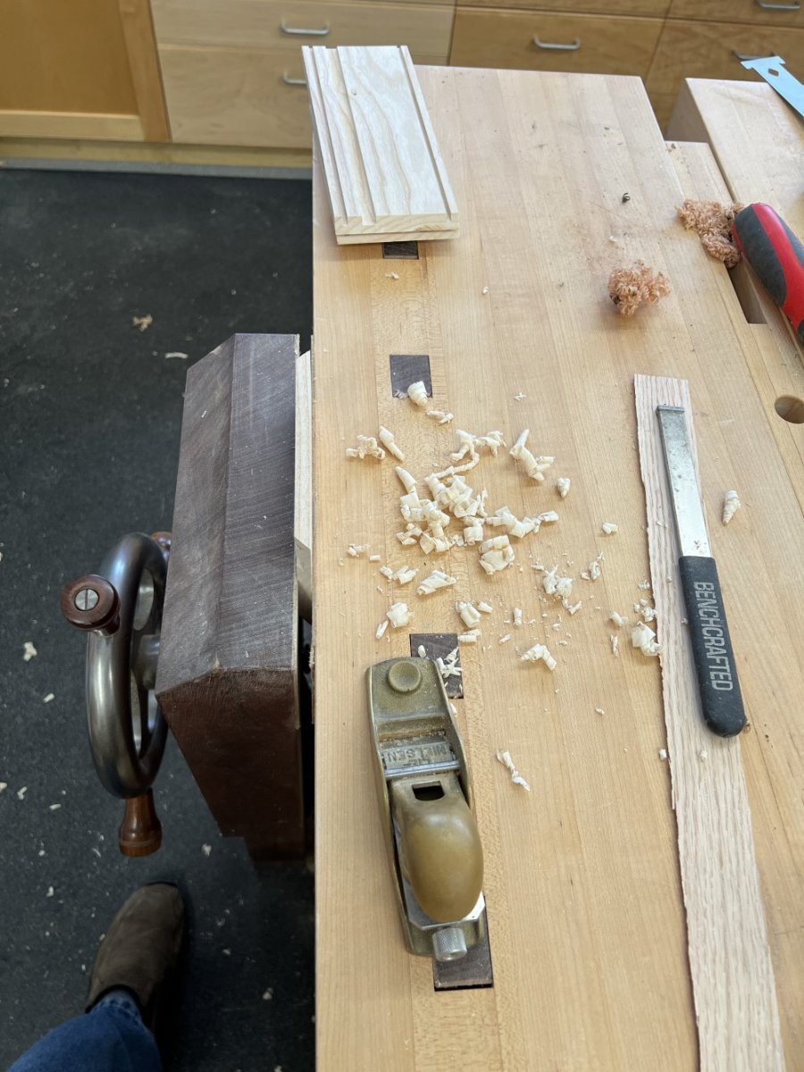

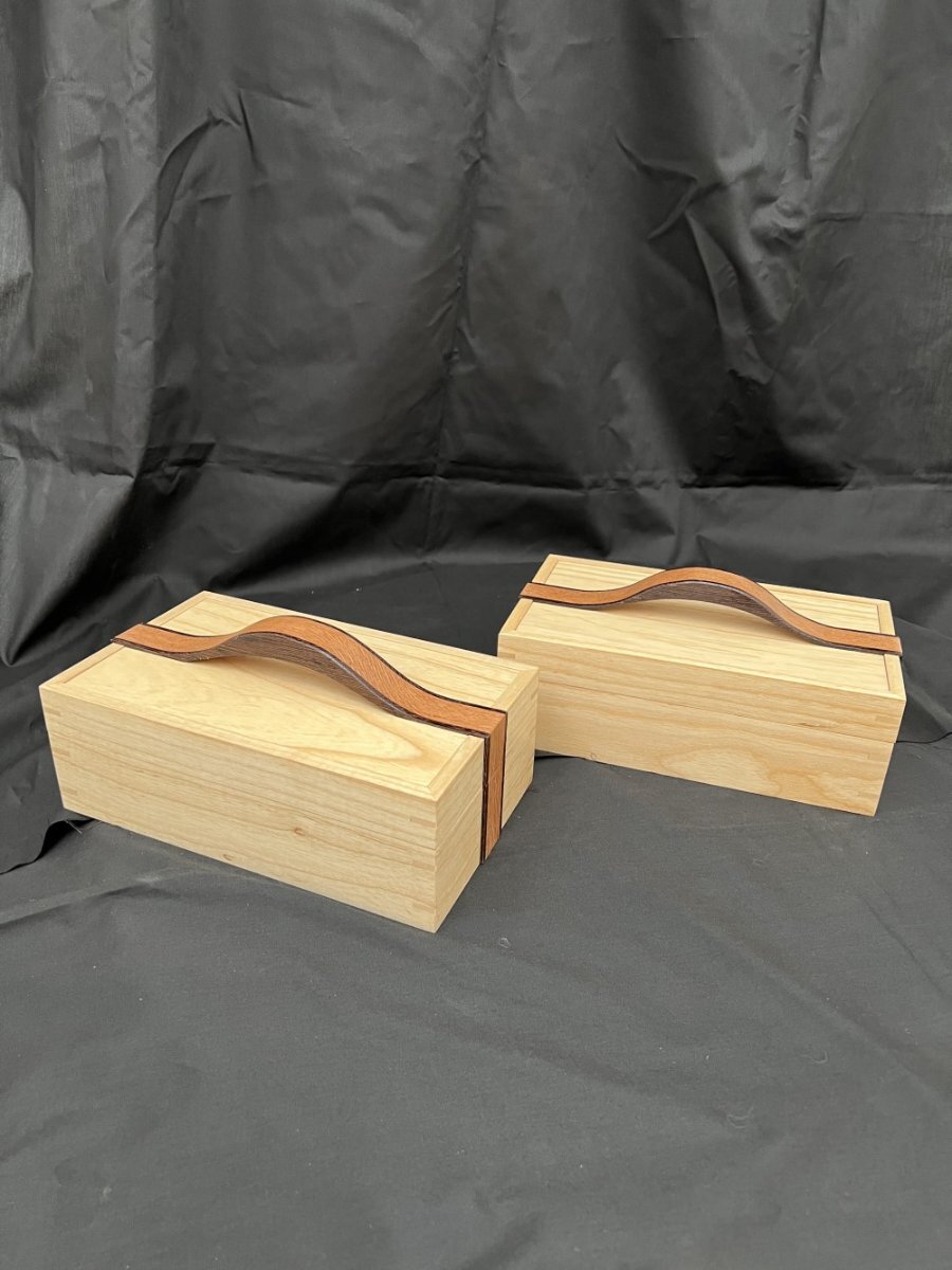

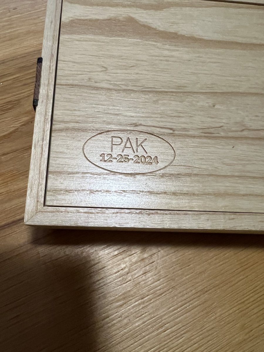

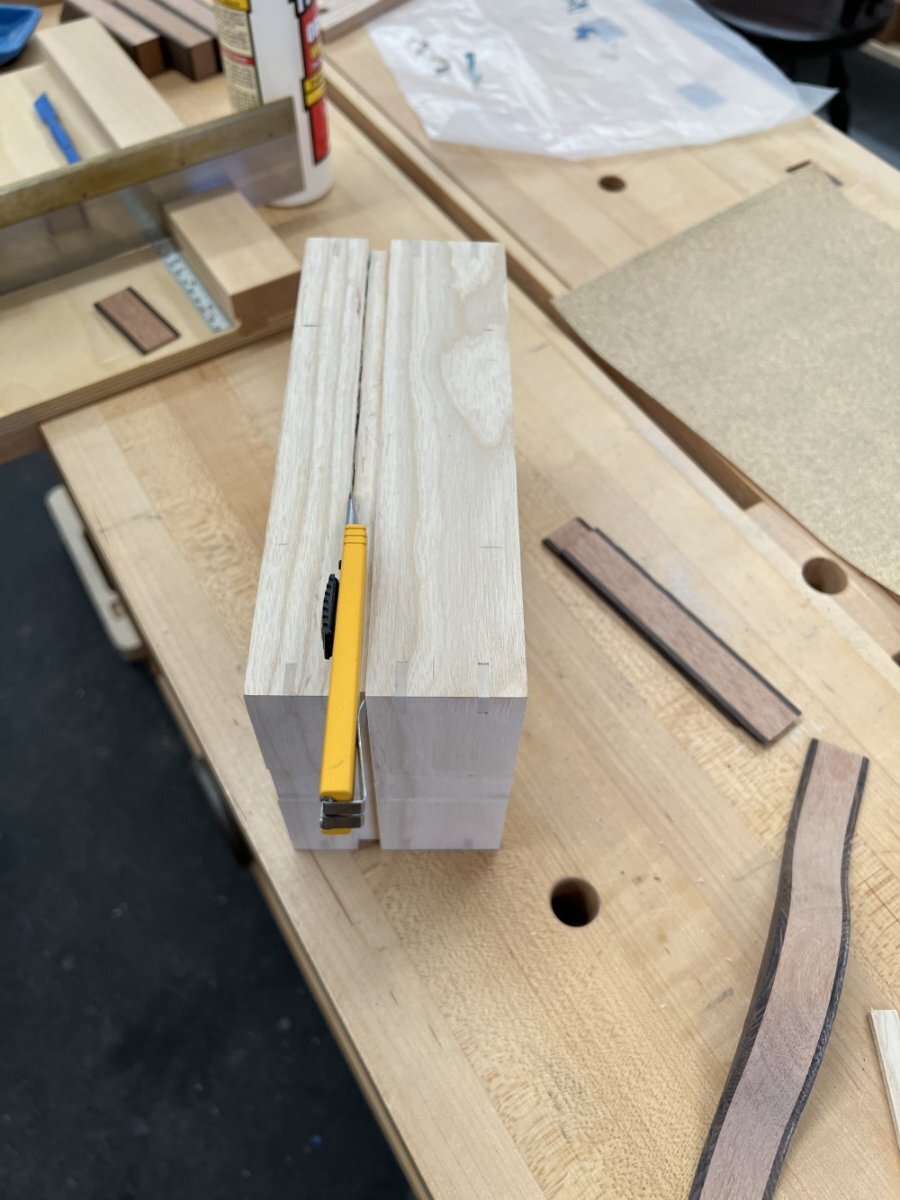

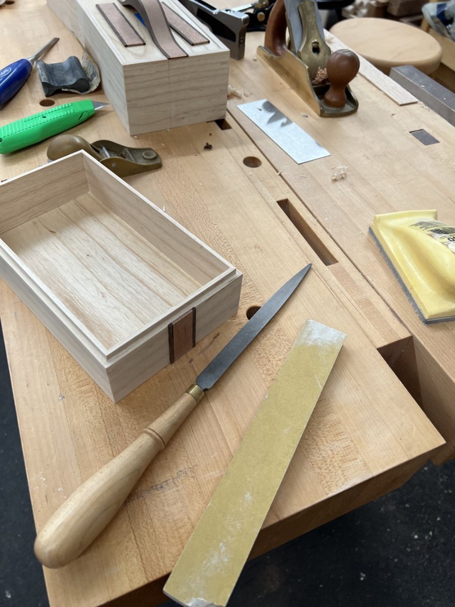

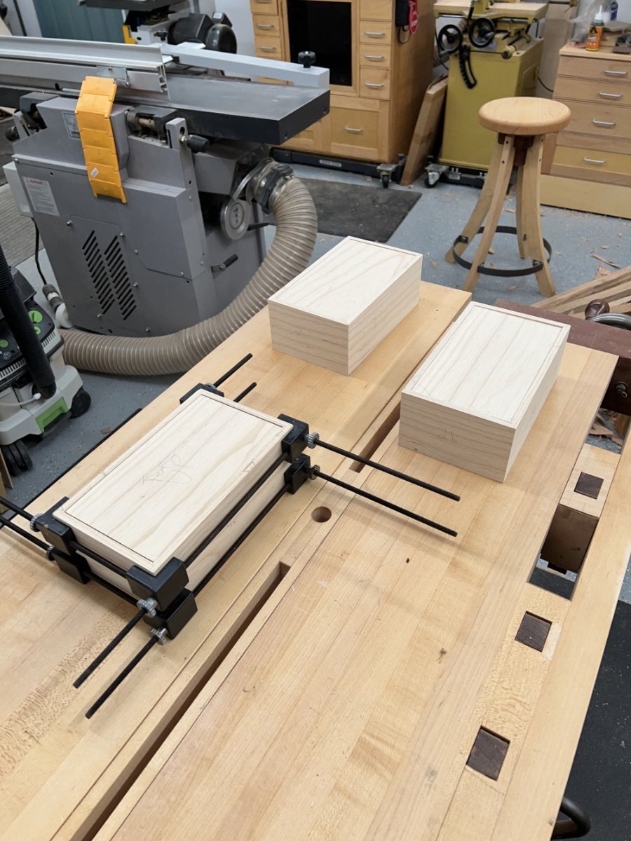

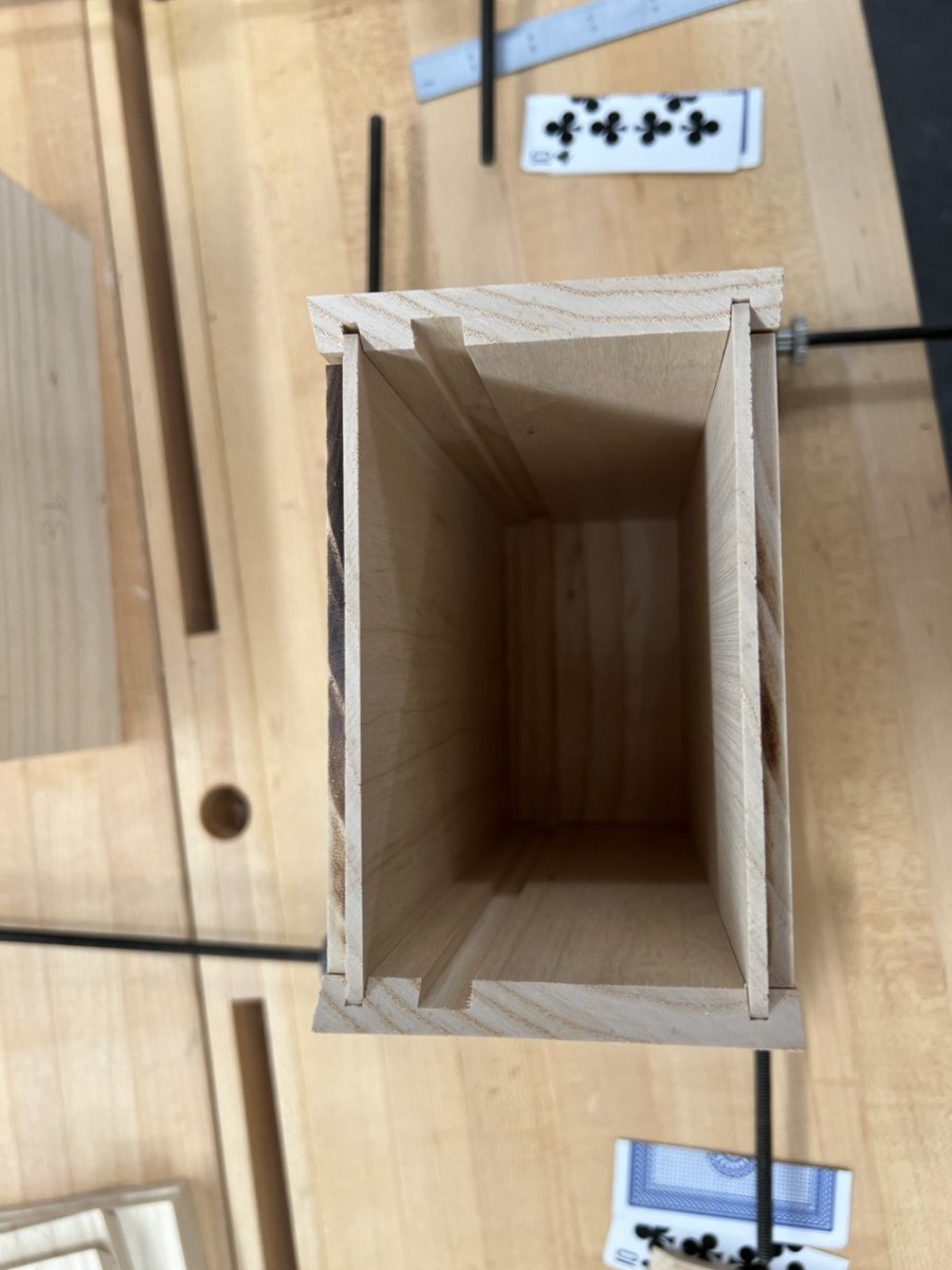

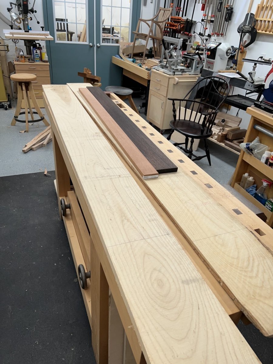

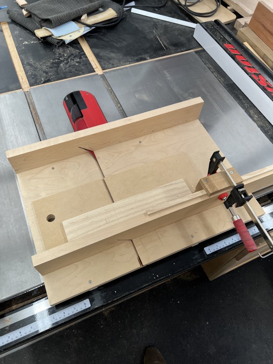

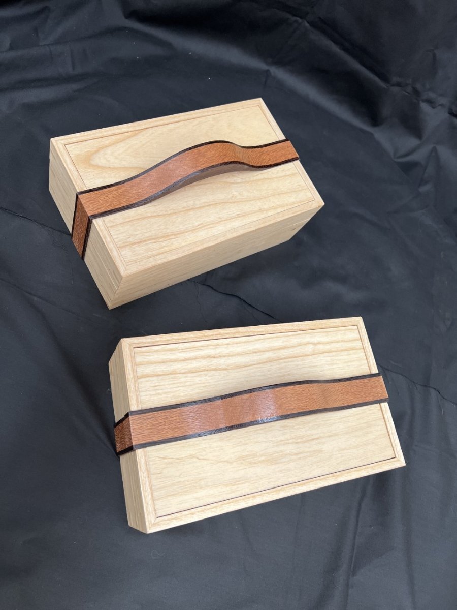

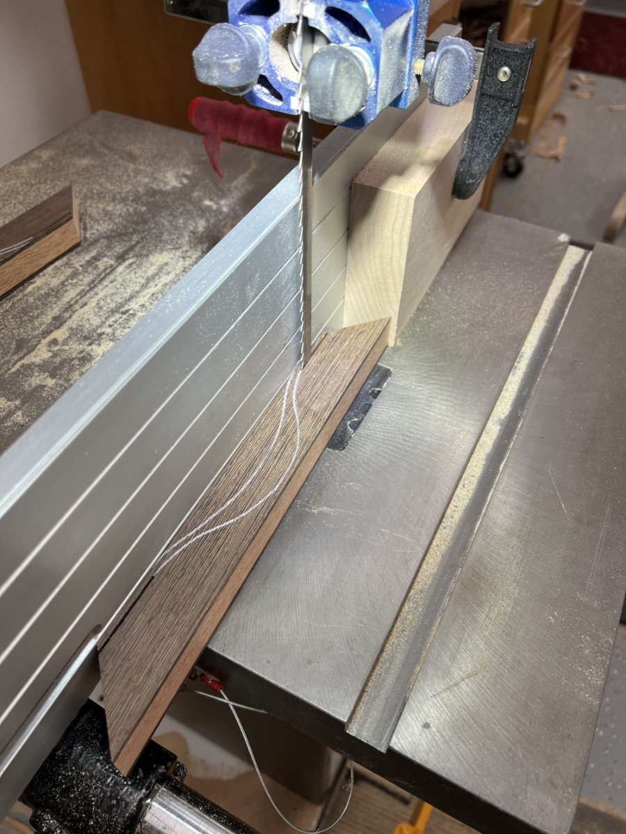

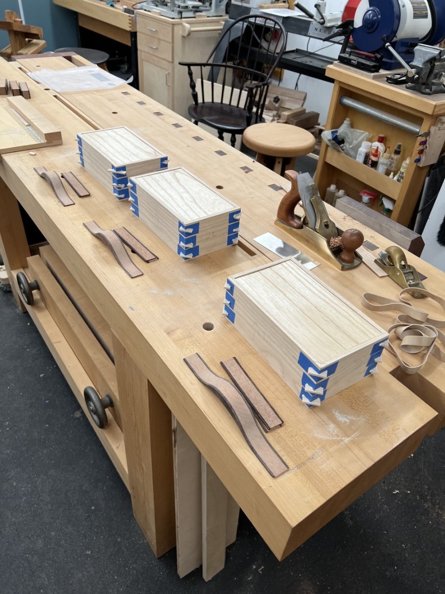

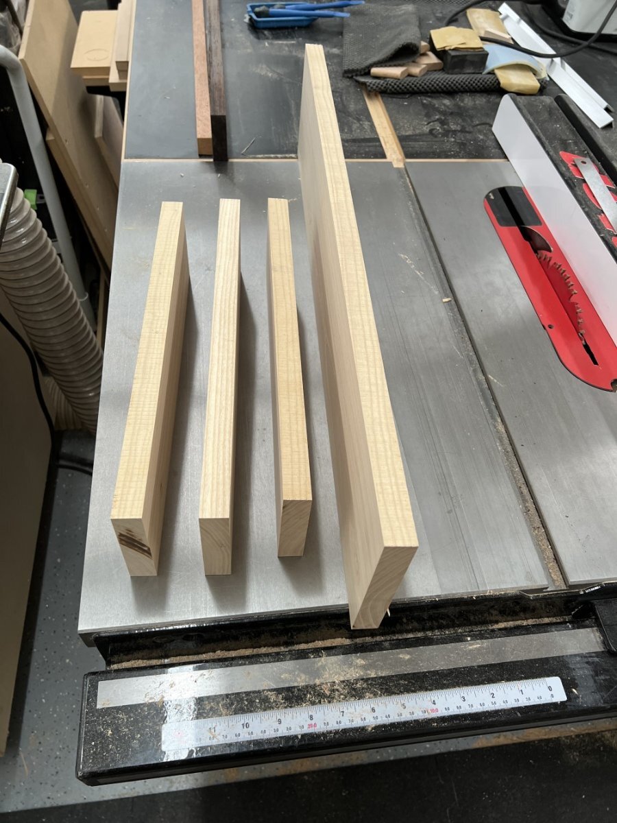

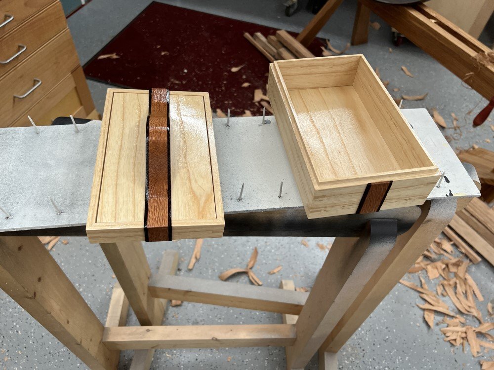

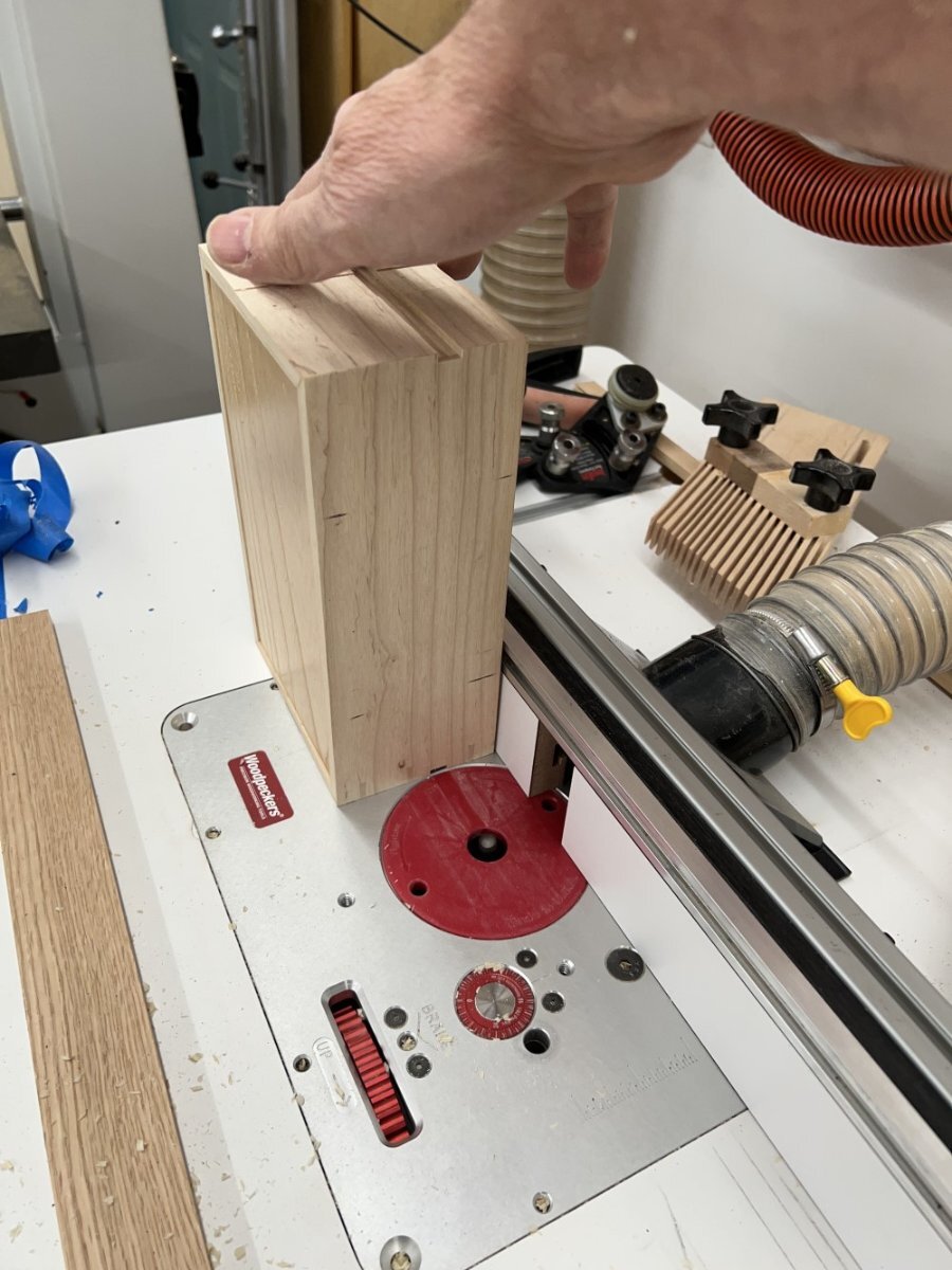

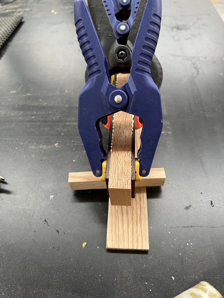

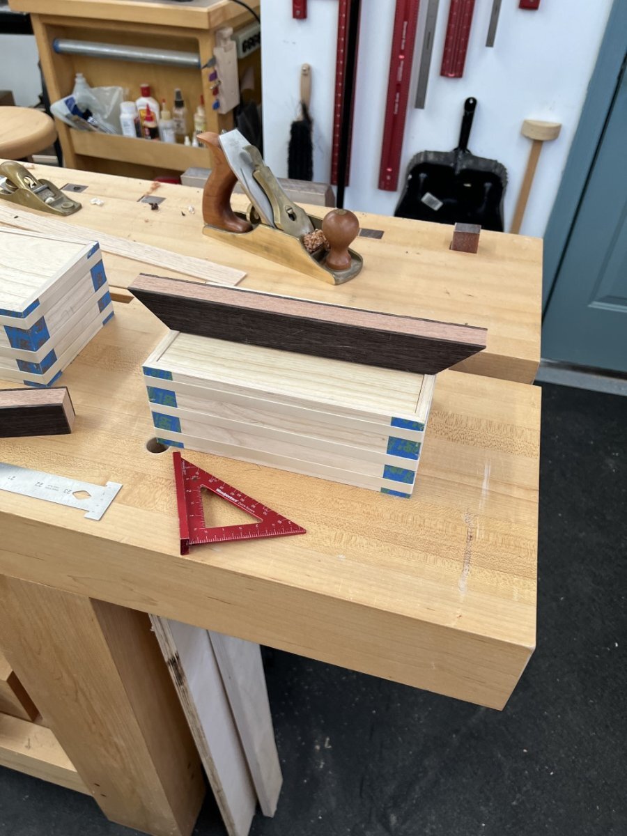

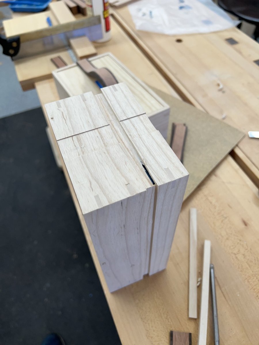

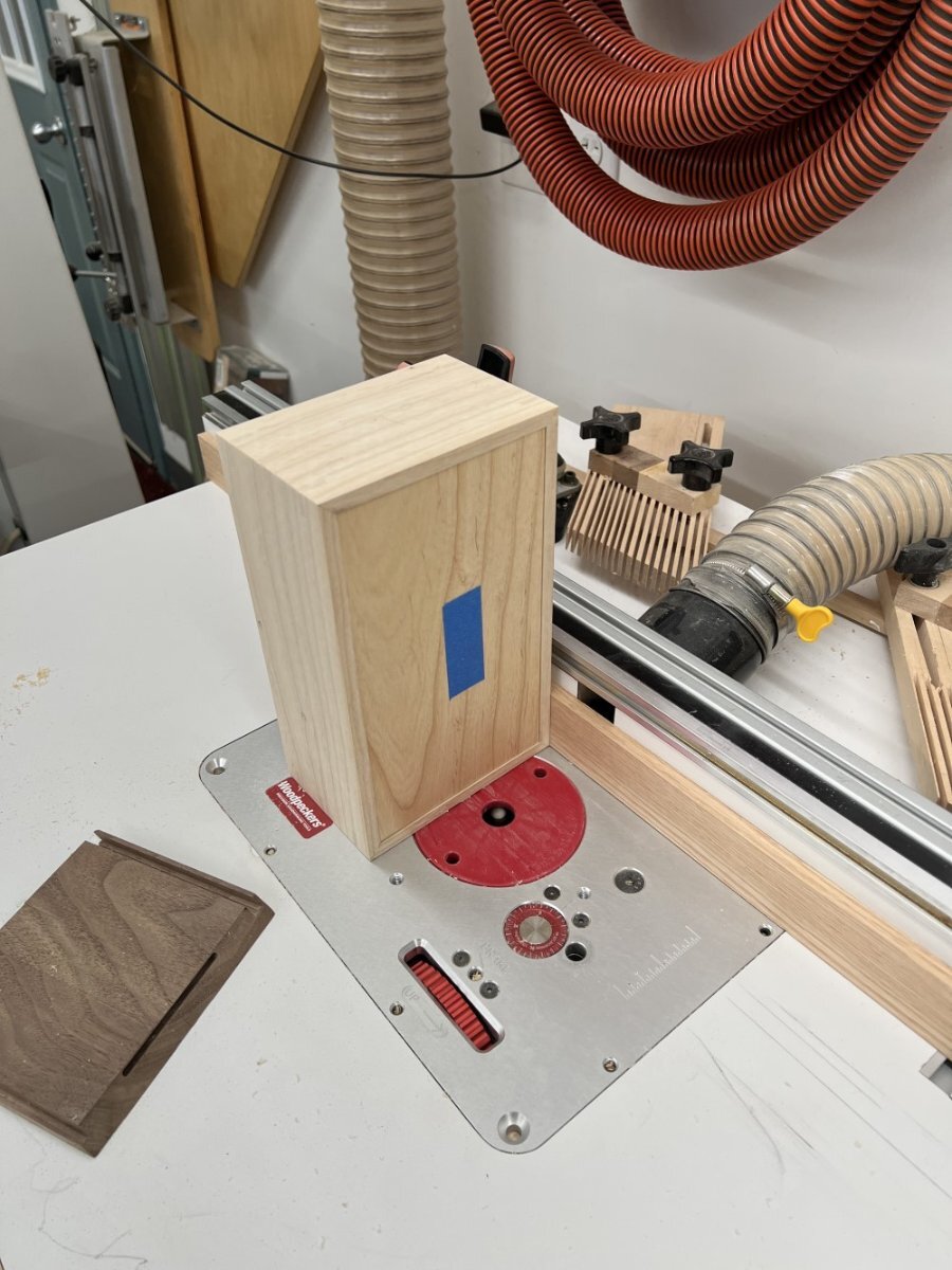

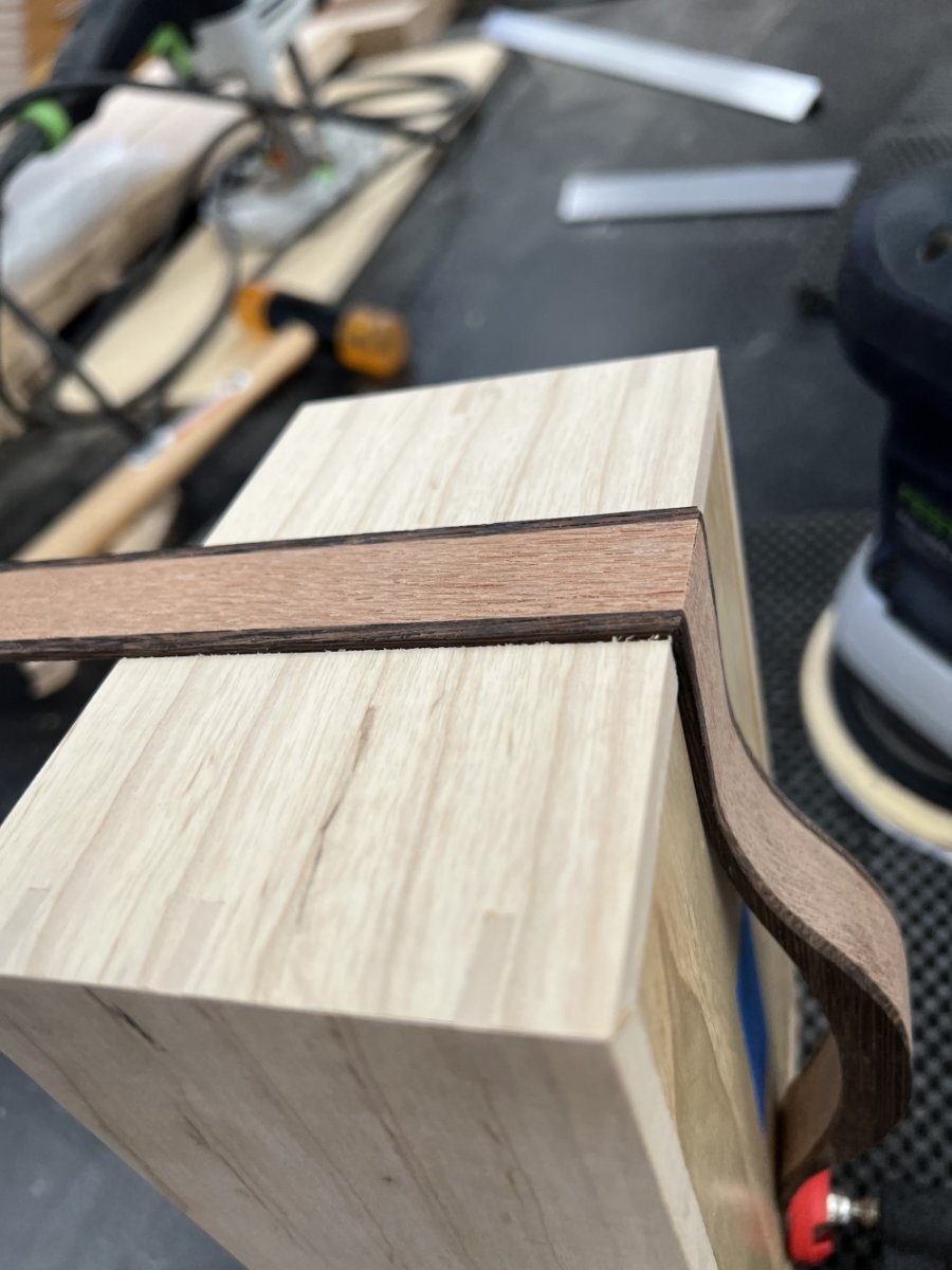

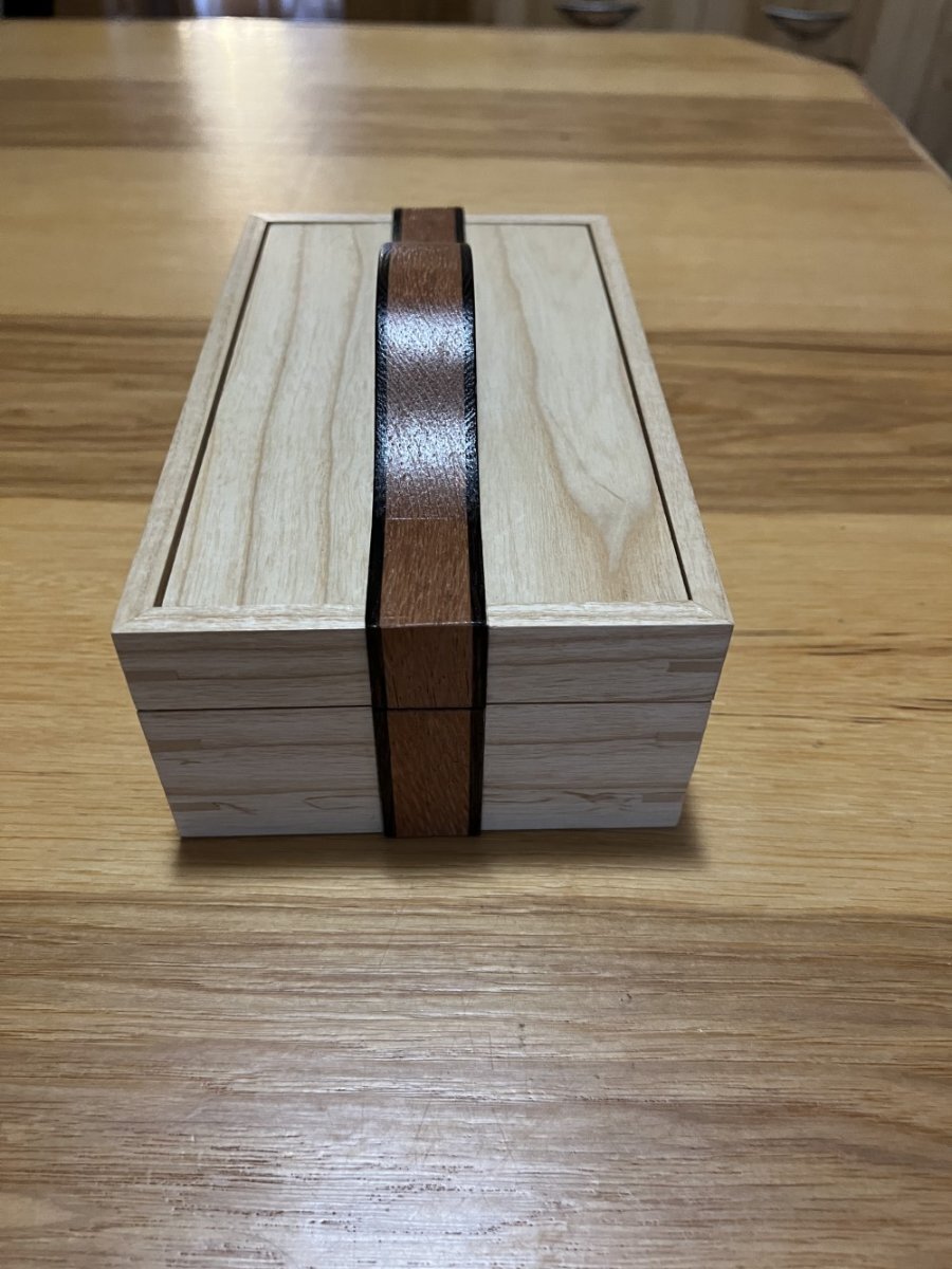

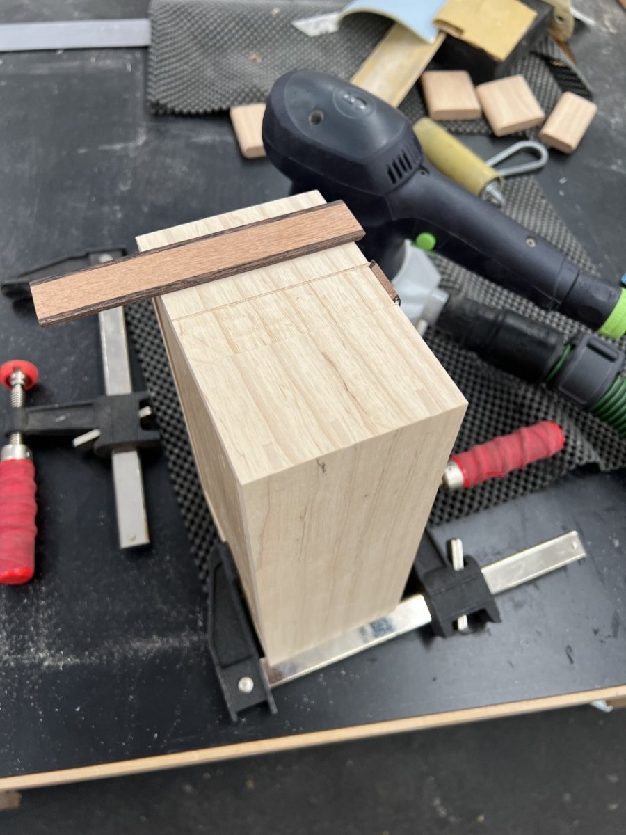

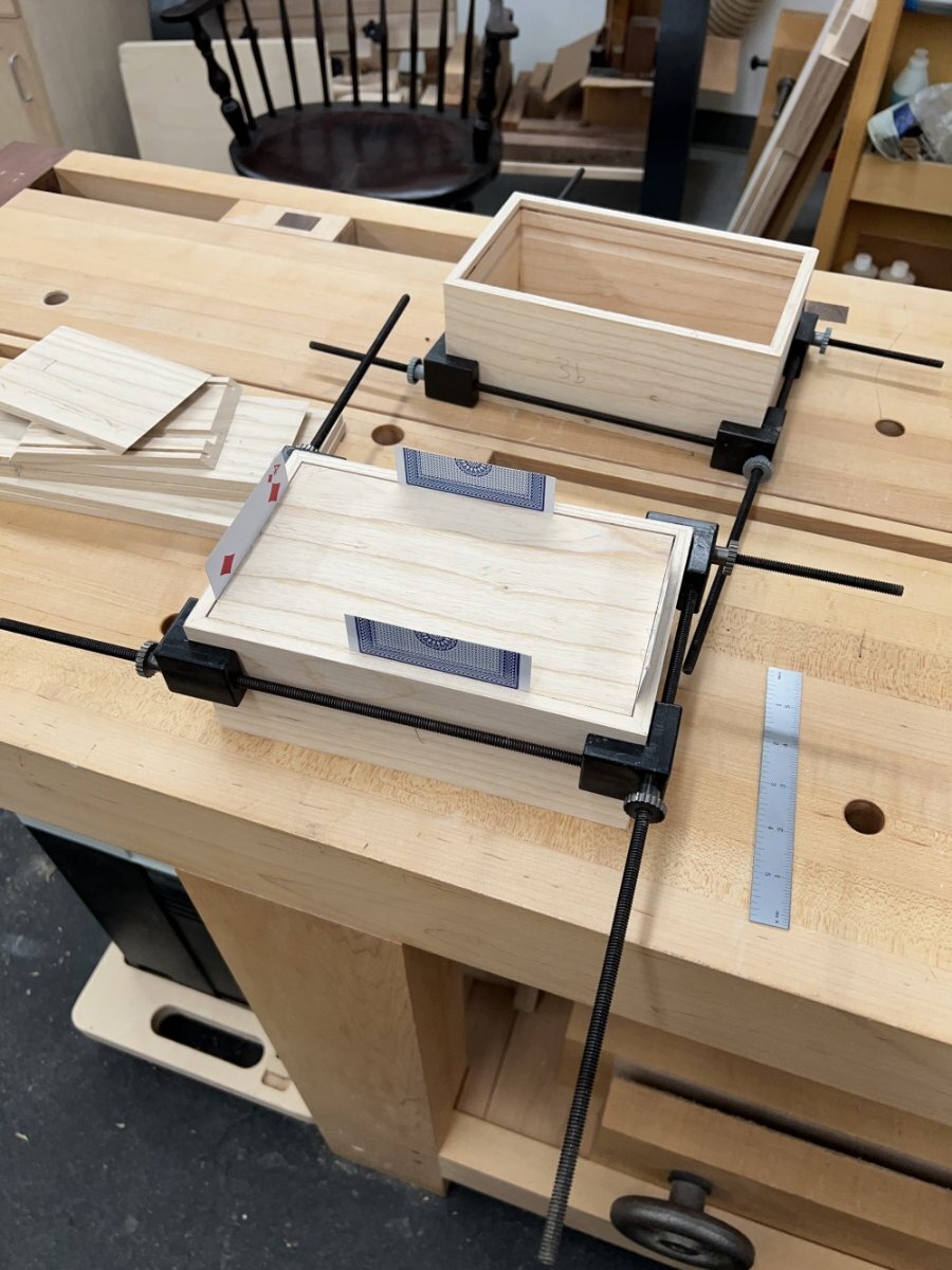

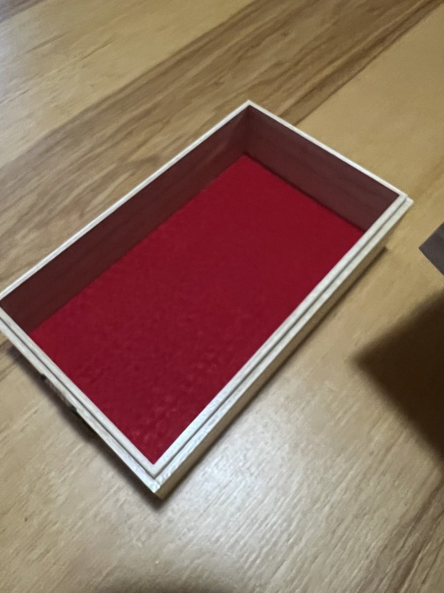

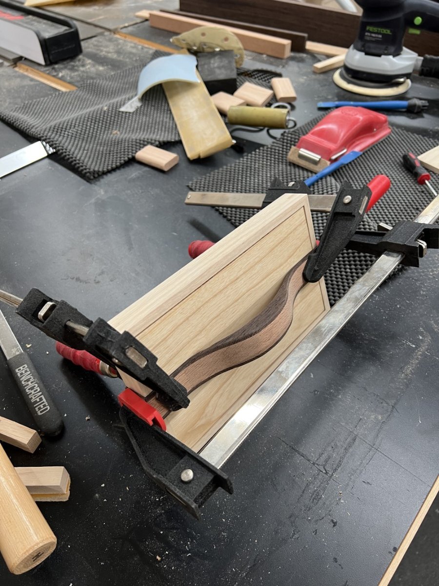

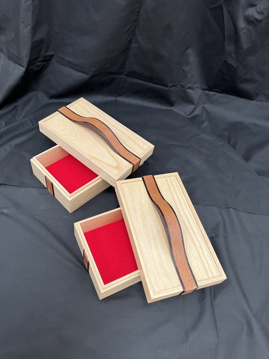

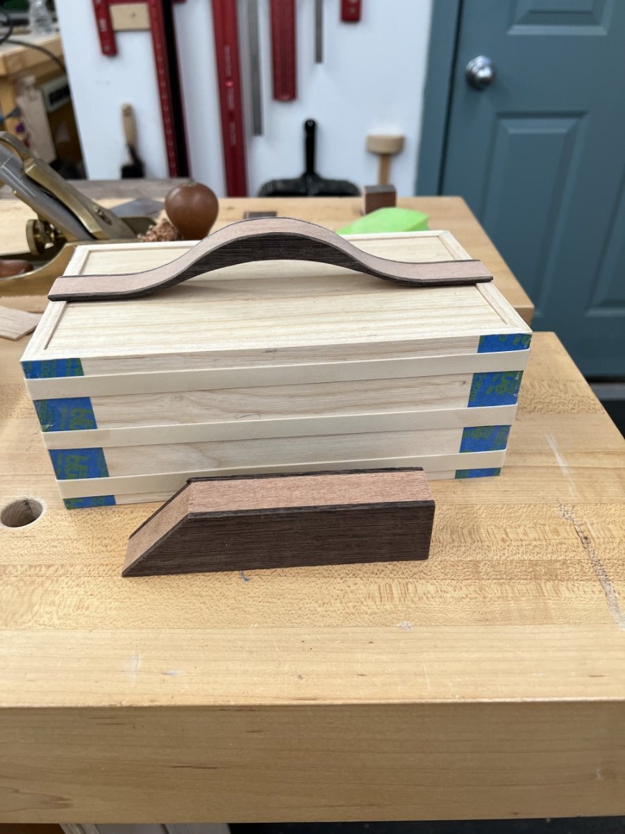

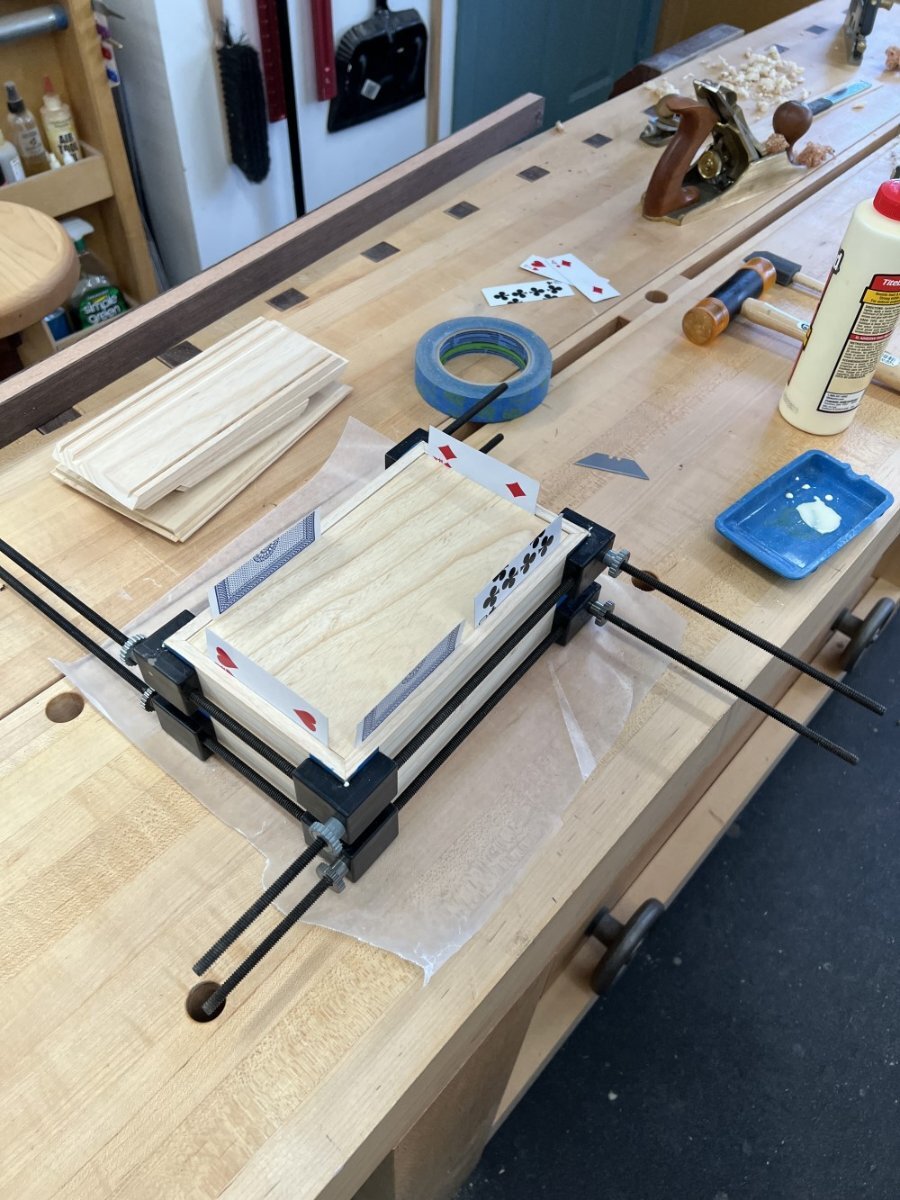

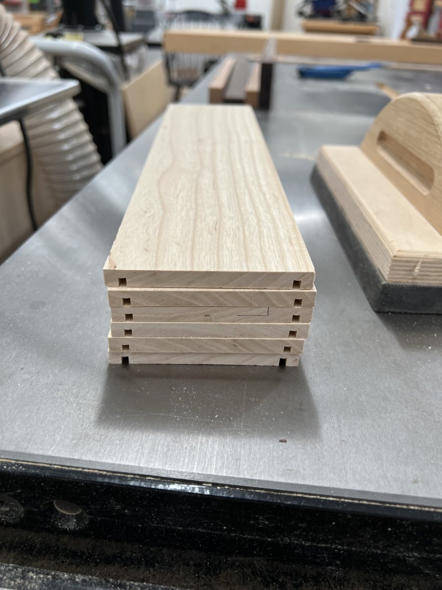

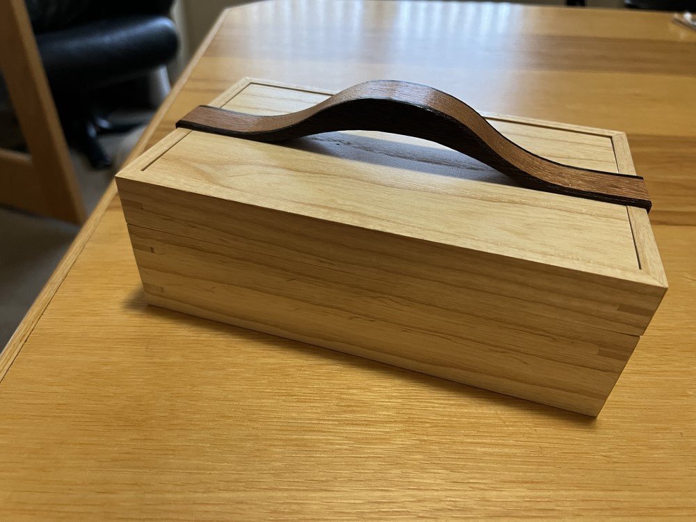

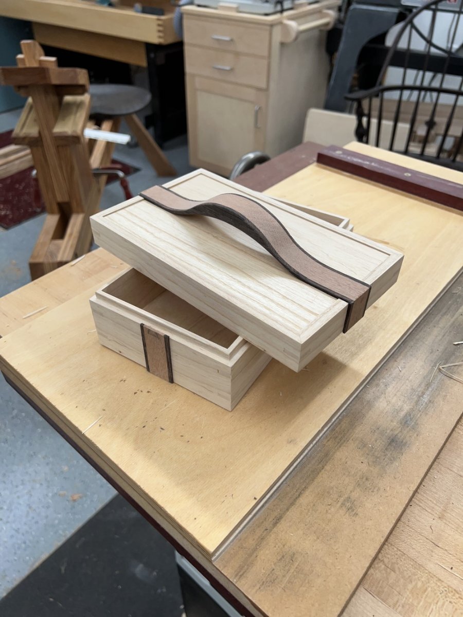

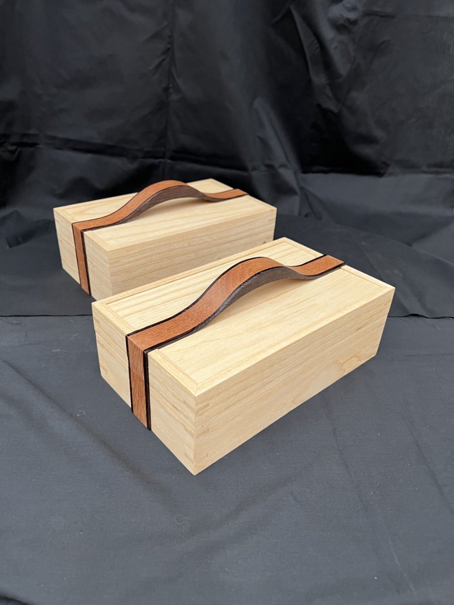

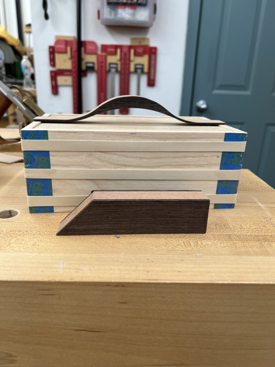

Popular Post pkinneb Posted December 31, 2024 Popular Post Report Posted December 31, 2024 As requested here is a quick build journal on three boxes I made for Xmas gifts this year. After receiving my order for the handle lumber (Wenge and Lacewood) from Bell Forest Products I started the milling process. The boxes are made of ash I had on hand. First up was to resaw the wenge into a 1/8" strips for the handles. Then I glued them and the lacewood up. I started using clamps but ultimately decided to throw the sandwich into the vacuum bag Next up I milled the stock for the boxes. Cutting to size at the table saw before resawing at the bandsaw. Then routed in some grooves for the top, bottom, and box lid (more on this later) Next I cut the 45s and test fit Here you can see the 3/8" in dado I will use as the inside portion of the top lip I use playing cards to get my gap around the top and bottom panels even After test fitting all three it was time to clean up the edges with a plane and start the glue up process. I started with box clamps and switch to rubber bands after about 30 min. Then I cleaned up the handle stock and cut the 45s as they would be very difficult to cut on 1/16" material. I cut one handle, cleaned it up at the spindle sander, and used it for the pattern for the other two The cut offs will be used for the side ribbons. With the 45 already cut just need to resaw two 1/16" thick 1" wide strips. Next up I cut the splines in the boxes. I use spacers so I can do all three boxes with little set up. Then after milling some stock I glued them in After cleaning them up at the bandsaw, and a quick hit at the edge sander, they were ready to route the ribbon banding and handle dadoes at the router table. I used a 3/8" bit and the groves are 1/32" deep and 1" wide so they were done in three passes. You can see the 1/2" board I use as a spacer so I could cut each side and then remove it for the clean up pass in the middle thus have them perfectly centered in the box. Now it was time to cut the lid apart form the box bottom. Again using a 3/8" bit set to leave about a 1/32" strip from the one we cut earlier I cut the groves all the way around the box. You can see how close in this pic I cut them apart with a sharp utility knife. then clean them up with a quick sanding using the flat TS top as my base. After cleaning those up we could start to attach the handles and ribbon we prepped earlier Then the ends were cleaned up with a rasp and sanding block ...and with that they were ready for a quick final sand and spray of my favorite box finish, rattle can Deft Clear Wood Semi Gloss. Had to spray them in the main shop since I have some pool table spectator chairs being finished in the spray room. I also glued felt to posterboard for a bottom finish Oh and used the Shaper Origin earlier to add my signature ...and some final shots of two, one had already been delivered 4 1 Quote
fcschoenthal Posted December 31, 2024 Report Posted December 31, 2024 Beautiful boxes. You often won't see the slip fit lids made that way anymore. Most will cut taller inside liners instead. 1 Quote
Von Posted December 31, 2024 Report Posted December 31, 2024 Great looking boxes. Thank you for the journal. Seeing how you made the ribbons and separated the boxes was particularly useful to me. 1 Quote
Mark J Posted December 31, 2024 Report Posted December 31, 2024 Thanks for the show & tell. Those really came out quite pretty! When you cut the curved part of the handles was that all done on the bandsaw? Freehand following the curved line? Or a physical template with some sort of bandsaw follower? 2 Quote

Popular Post pkinneb Posted December 31, 2024 Author Popular Post Report Posted December 31, 2024 On 12/31/2024 at 9:13 AM, Mark J said: Thanks for the show & tell. Those really came out quite pretty! When you cut the curved part of the handles was that all done on the bandsaw? Freehand following the curved line? Or a physical template with some sort of bandsaw follower? On the BS freehand except the 1/16" ends I used the fence for those, then cut the curve and cleaned up with a spindle sander. I did some final clean up with a foam sanding pad after glue to prep for finish. 3 Quote
