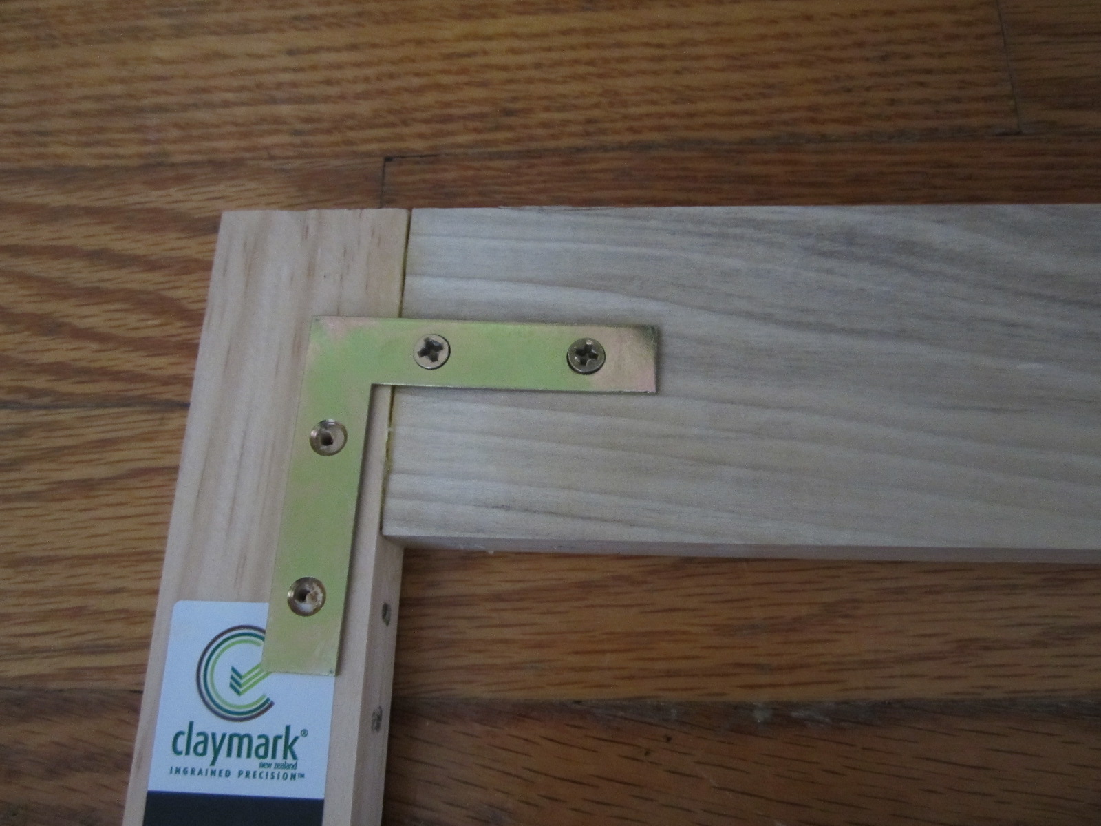

tunic Posted January 28, 2015 Report Share Posted January 28, 2015 I have a large and heavy mirror (approx 3x3). The corners are connected by dowelled miter joints. Not sure how it happened, but the back of one corner appears to have blown out: http://i.imgur.com/4LiIXwD.jpg I could not make the corners flush with eachother due to the dowel overlapping the broken corner in previous image. I sawed off the intact miter dowel thinking I could simply attach a brace to the back and get everything flush again: http://3.bp.blogspot.com/-ckPY8A11PGk/Ucx0jO0j2xI/AAAAAAAAAX4/17dJiNtmbSY/s1600/assembly2.JPG(similar idea) Found that the force that I have to use in order to get the two corners flush again is substantial. I do not believe the brace was a good idea to begin with. But now I'm not sure how to repair my mirror. As you can tell I am not familiar with woodworking or repair. Humbly hoping for advise if possible. After being on Google for some time, thought this would be the closest to a feasible repair: http://www.ripsdiy.co.za/graphics/woodnailingmitre.jpgOr Drilling through corner, inserting dowel and glue. Additional bad picture of frame: http://i.imgur.com/NEAOt9r.jpg Thank you. Quote Link to comment Share on other sites More sharing options...

Rvlewis Posted January 29, 2015 Report Share Posted January 29, 2015 If you have the broken piece, I'd first glue that back on. If not, I'd probably first make the repair, then use an epoxy wood filler to fill the hole and sand smooth. As for the repair, I'd consider using a band clamp long enough to go around the perimeter, put some glue in the joint, then tighten the band clamp around the frame perimeter, which would hopefully pull the broken joint back together. If the band wasn't strong enough, as I suppose it likely isn't, I'd probably just use two long bar clamps, one in the north-south direction and the other in the east-west. Alternately tighten them little by little until the blown-out joint was back together. Let dry overnight before removing clamps. Use good quality glue like Titebond II or III. You don't really need the waterproof III, but to be honest I use it for pretty much anything I glue. Glue and decent clamps can be found at places like Home Depot. I've done something similar before and found the joint glued up well and didn't really need another dowel to be strong enough. Quote Link to comment Share on other sites More sharing options...
wtnhighlander Posted January 29, 2015 Report Share Posted January 29, 2015 I saw the post earlier, but the firewall at work blocked the image links. Now that I can see it, the damage is pretty severe. Do you hope to keep the stained wood finish? I think it is going to be difficult to repair and still look good, unless you are willing to paint. The strongest option I can think of is to remove the damaged rail and make a new one. That may be outside your comfort zone. Can you tell what is preventing the ends from coming together as they should? It looks like maybe the mirror is still in the frame, or at least the back is still attached. Remove the mirror and back, and the frame corner should mate up so that you can glue it. I suggest glue on what surface is left, hold it together with tape, clamps, string or whatever you have, then drill and countersink a screw hole through the damaged corner into the good one. Install the screw, then use wood putty to fill the damage and cover the screw. You can also glue in a dowel if you don't want to use a screw. In either case, the repair is going to be somewhat visible unless you paint over it. Another, but more tedious option, is to saw out a square chunk around the damaged area, leaving as much of the mitered edge as possible. Cut a square if wood to fit the new opening, but long enough to extend past the miter. Glue in the patch, and once it is dry, trim the excess, using the original sections of the miter as a guide. Then put the miter back together as described above. This avoids using putty, and is a bit stronger, but won't really look any better. Quote Link to comment Share on other sites More sharing options...

tim0625 Posted January 31, 2015 Report Share Posted January 31, 2015 +1 on what they said....just make sure you have it pulled as tight as you can get it and then one or two long screws Quote Link to comment Share on other sites More sharing options...
