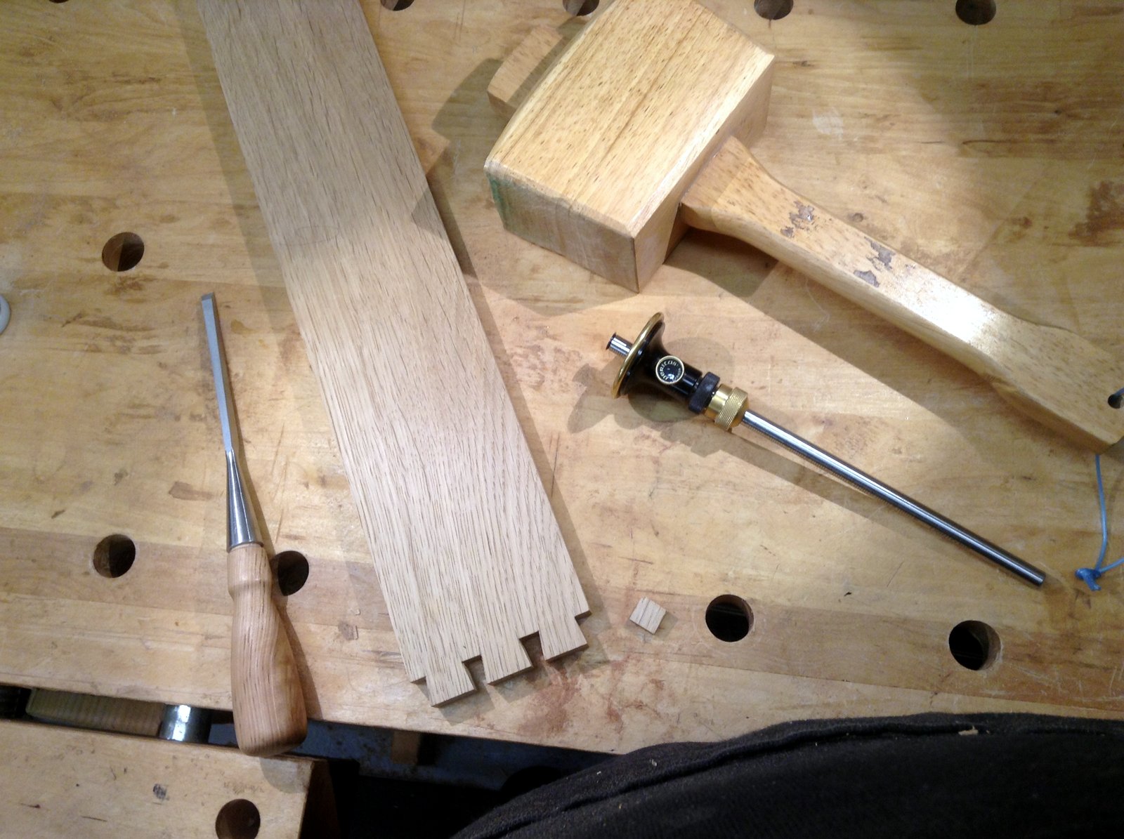

  • We've got a problem (Houston) I was chopping some dovetails and Anna the shop cat decided I wasn't paying her enough attention...
