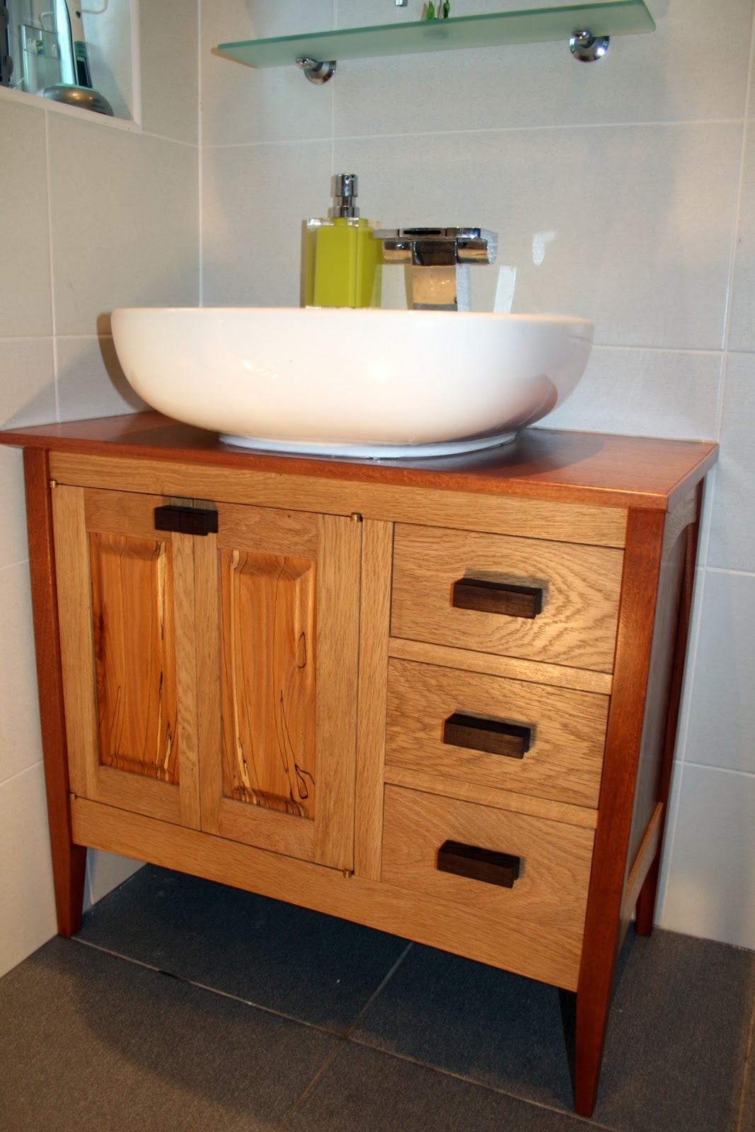

I have some nice spalted beech that I used in the doors of my wet room vanity that I finished last November.
Terry,
that's a great looking vanity.  did you use a modified version of Marc's chest of drawers concept?  the sides remind me of that.
