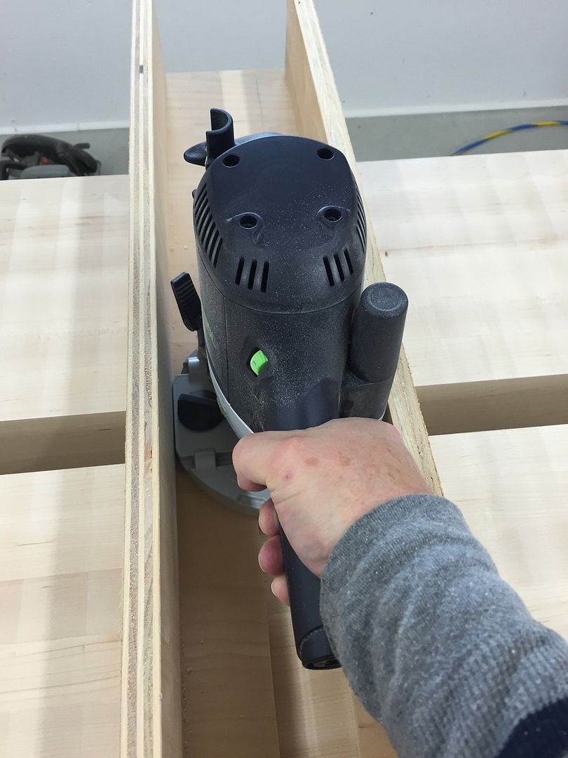

Well found out today I like the 1400 grip a little better - it was perfect for flattening my Roubo.
