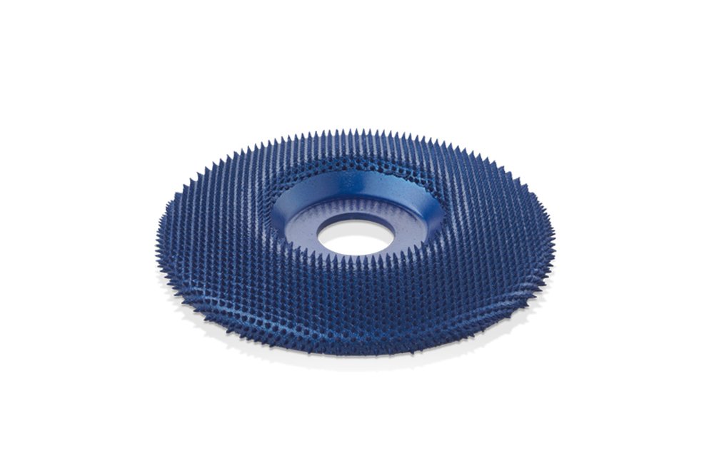

Eric. Posted August 10, 2016 Report Posted August 10, 2016 A slightly cheaper alternative if you're not hung up on using only hand tools...an angle grinder and carving disc can be had for less than a hundred beans...and you can probably find discs for cheaper but I wouldn't know how well the budget ones work. You'll certainly use the grinder again, if not for more sculpting then a random DIY project. https://www.amazon.com/PORTER-CABLE-PC60TAG-6-0-Amp-2-Inch-Grinder/dp/B004X5NNGG/ref=sr_1_4?s=power-hand-tools&ie=UTF8&qid=1470847178&sr=1-4&keywords=angle+grinder https://www.amazon.com/Kutzall-Extreme-Carving-Disc-Tungsten/dp/B00EIO0T2I - OR - If you told me you couldn't find a used travisher on ebay for less than $50 shipped...I wouldn't believe you. 1 Quote
James Wright Posted August 10, 2016 Report Posted August 10, 2016 You can use a grinder with a flap disk to carve it out. you could use gouges to take out most of the material. for more of the final work you could use a card scraper. Also, you could try and find a bowl gouge, but new would be over $100. you could make a travisher just a curved Spoke shave. 1 Quote
Isaac Posted August 10, 2016 Author Report Posted August 10, 2016 3 minutes ago, Eric. said: A slightly cheaper alternative if you're not hung up on using only hand tools...an angle grinder and carving disc can be had for less than a hundred beans...and you can probably find discs for cheaper but I wouldn't know how well the budget ones work. You'll certainly use the grinder again, if not for more sculpting then a random DIY project. https://www.amazon.com/PORTER-CABLE-PC60TAG-6-0-Amp-2-Inch-Grinder/dp/B004X5NNGG/ref=sr_1_4?s=power-hand-tools&ie=UTF8&qid=1470847178&sr=1-4&keywords=angle+grinder https://www.amazon.com/Kutzall-Extreme-Carving-Disc-Tungsten/dp/B00EIO0T2I That is a great suggestion. I actually have that exact grinder, I hadn't thought of that at all. Hand carving it is appealing, but I'm going to ponder on this. It looks like the disc you suggestion comes in a variety of grits, is the course the way to go for this function? I imagine so, to remove enough material, but just checking. Does the travisher have another name? I did check on Ebay, but only found two postings, one was just an iron and the other for $126. I could take the iron and make my own, though frankly I'm not really sure what I'm looking at or how it would be constructed. Quote
James Wright Posted August 10, 2016 Report Posted August 10, 2016 1 minute ago, Isaac Gaetz said: That is a great suggestion. I actually have that exact grinder, I hadn't thought of that at all. Hand carving it is appealing, but I'm going to ponder on this. It looks like the disc you suggestion comes in a variety of grits, is the course the way to go for this function? I imagine so, to remove enough material, but just checking. Correct you could just do it with two grits and then hand sand or scrape the finish. also if those cost too much you can get flap disks for the grinder. they are cheaper. but the wood grinding head is a lot faster and more fun. 1 Quote

Eric. Posted August 10, 2016 Report Posted August 10, 2016 40 minutes ago, Isaac Gaetz said: Hand carving it is appealing, but I'm going to ponder on this. It looks like the disc you suggestion comes in a variety of grits, is the course the way to go for this function? I imagine so, to remove enough material, but just checking. I have no personal experience with the Kutzall discs because I've always used the Arbortech Turboplane https://www.amazon.com/Arbortech-IND-FG-400-Turbo-Plane/dp/B008NA2IJ0/ref=sr_1_1?ie=UTF8&qid=1470849941&sr=8-1&keywords=arbortech+turboplane and its crazy older cousin https://www.amazon.com/Arbortech-IND-FG-200-Industrial-Pro-Kit/dp/B003DPX4HK/ref=sr_1_1?ie=UTF8&qid=1470850062&sr=8-1&keywords=arbortech+industrial+woodcarver But I've seen Marc use the Kutzalls so I'm sure they work fine. I bet they throw a ton of dust though. Respirator, fo sho. Quote

Isaac Posted August 10, 2016 Author Report Posted August 10, 2016 Thanks for the input everyone. I think that is the way I'll go since I already have a grinder. I'm actually getting excited. I wonder if anything else in my shop could use a bit of grinding.. Quote

wtnhighlander Posted August 11, 2016 Report Posted August 11, 2016 HF has a kutzall-type disk, as well as the king arthur deathtraps (chainsaw wheels). Another hand tool option I've seen St. Roy use is called a Scorp. Something else to look for on ebay. I have the HF grinder with the paddle switch, and a kutzall brand wheel. Works great for sculpting wood, but I don't believe any dust collection system on the market can keep up with the cloud it generates. Use it outside, and wear a mask. 1 Quote
