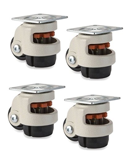

I know you changed to thinking Workbench casters, but at work we've used these heavy duty casters for some very large equipment.
WoodRiver Machine Leveling Caster Plate Mounted 4 Pack
These are great. I used them for a mobile base for my PM1500
Oh those look good. Do the wheels swivel or are they straight roll only?
To move the table once it is set would I need to get my wrench and undo my level setting to lower the feet enough for rollers to move it? If so how long does that normally take... just curious

The wheels swivel, and roll very nicely. You do have to re-level after moving, but the adjustment can be made without a wrench (provided you don't have thousands of pounds on your bench).
